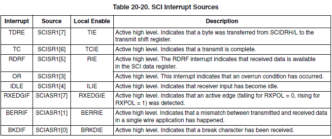

It is again hang after 29 hours. :smileysad:. After connecting debugger, I found that all RDRF/IDLE/OR/NF flags of SCI1SR1 were SET. The stack pointer was showing 300 bytes less than first Global variable location and I have assigned  2KB RAM for STACK.
So, now It is confirmed that this issue is not related with STACK. As discussed in  previous post, the other SCI flags are not clearing so the code might be locked in Serial ISR. When I ran the code from debugger, it started working again as usual. which is logical from earlier discussion.
I have set the only RIE bit in SCI1CR2 reg and expecting Serial Receive Full ISR only. So, I don't understand why code is staying in Serial ISR when OR bit is set. Can you plz explain?

RadekS
Hi Nandu,
Thank you for new details. So, it seems that we found a root cause.
Please let us know the result after SCI ISR fix.
There is just one shared interrupt for whole SCI module and various number of SCI interrupt sources which should/must be handled.
The exact number of interrupt sources and their handling will depend on you SCI configuration and application requirements.
The for loop in your ISR is a quite interesting solution (“just for sure” solution). Maybe just else branch may be enough in such case.

RadekS
Hi Nandu,
In the case of your routine, the problem may happen when OR/NF/FE/PF is set while RDRF flag is cleared.
Note from RM: OR flag may read back as set when RDRF flag is clear. This may happen if the following sequence of events occurs:
  1. After the first frame is received, read status register SCISR1 (returns RDRF set and OR flag clear);
  2. Receive second frame without reading the first frame in the data register (the second frame is not
received and OR flag is set);
  1. Read data register SCIDRL (returns first frame and clears RDRF flag in the status register);
  2. Read status register SCISR1 (returns RDRF clear and OR set).
Event 3 may be at exactly the same time as event 2 or any time after. When this happens, a dummy
SCIDRL read following event 4 will be required to clear the OR flag if further frames are to be received.
Please use rather something like:
