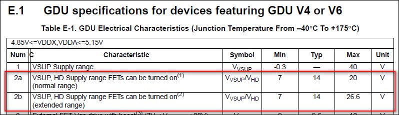

  The system voltage is two 12V batteries in series which is possible high to 32V(16V+16V) when the battery is full. We found an AN5082 that suggests users to add a regulator for the Vsup and a gate driver for high & low side MOSFET.
  The customer ask how to deal with this pin, HD ?

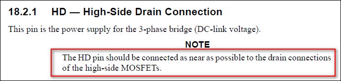

  This pin shall keep under 20V and be required to close to the drain connections of the high-side MOSFET which is the battery voltage(36V possibly).

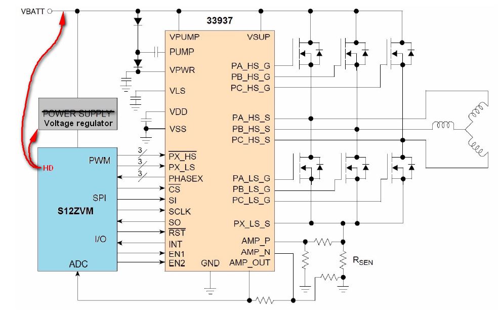

Where shall this pin, HD, connect to ?
Thanks.
Stanley
Message was edited by: Yao-Tsung Huang [ To cross out the power supply to be voltage regulator in the final image ]

Hi Stanley,
HD pin has to be connected behind external voltage regulator. We cannot connect more than 26V to HD pin - except short pulses (with no guarantee of function during this time).
In fact, In case of external gate driver, we do not use internal gate driver. Therefore note about required connection to close to the drain connections of the high-side MOSFET is not valid in this specific case.

The S12ZVM family was designed for 12V motor control applications.
The highest voltage for GDU is 26.6V (Note: Operation beyond 20V is limited to 1 hour over lifetime of the device).
When we add 12V for high N-channel MOSFET and margins, we are close to breakdown voltage for this 180nm technology.
So, you will need external gate driver for 24V motor control application.
Additionally, the typical load dump voltage for 24 systems is 60V – it means, that you also need overvoltage protection circuit.
