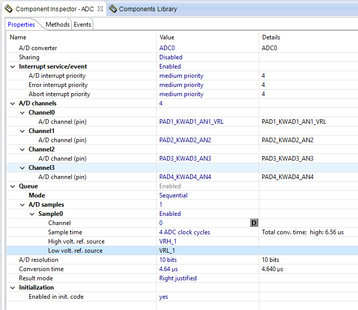

I want to use 4 ADC channels of 10 bit. I have configured for 4 but getting output of only first channel.
I configured as below.
and written code

but when I check variables value then getting same value that is only PAD1 value.
I am passing different channel numbers still getting only one pin output.
How I can access for ADC 4 channel.

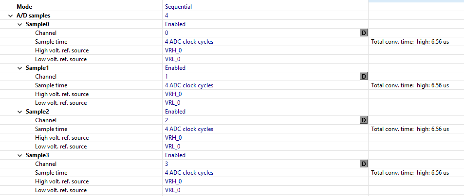

danielmartynek
Hi chaitanya.kalyani@seoyonelec-rnd.in,
Could you configure all four samples:
BR, Daniel
