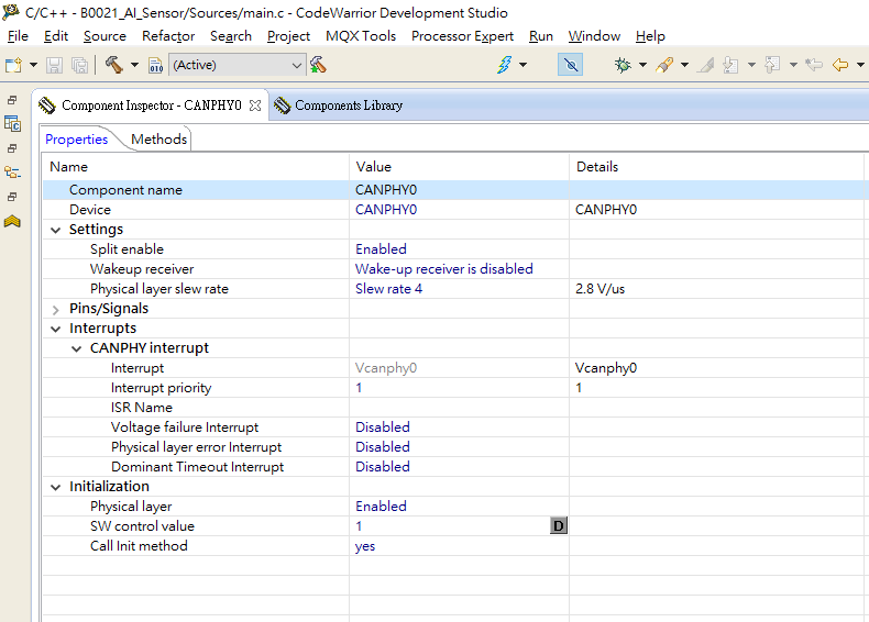

We use 10 boards(S12ZVCA) to send CAN message every 10 seconds. And 1 board(S12ZVCA) to collect those CAN message.
It can work fine in 10 meters cable. But it is unstable in 200 meters cable. How to solve the issue? Do you have any recommend?
Slew rate: 4
Baud rate: 250kbps
Time segment 1: 4 (We will try "12" on next Monday)
Time segment 2: 1
RSJ: 1
Sample per bit: 3 samples

We only change Time segment 1 from 4 to 12. It can work stable in 200 meters cable.
The parameter as follow:
Slew rate: 4
Baud rate: 250kbps
Time segment 1: 12
Time segment 2: 1
RSJ: 1

lama
The long transmission line has its own distributed parameters. They creates reactance which depends on frequency. Moreover, they deforms edges of signals.
So you can solve your issue:
Decrease bitrate
Do correct bitrate calculations including real propagation delays ( https://www.nxp.com/docs/en/application-note/AN1798.pdf )
Use wires with low R/L/C parameters.
Use some repeaters.
Wireless CAN
For this distance probably you could use RS485 and UART.
Ladislav
