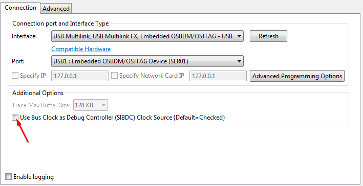

i am currently using the TRK S12ZVH128 evolution board for pre-development.
I am trying to set the CPU Bus frequency up to 32Mhz (Max frequency).
Unfortunately the code always crashes when I try to set the CPMUSYNR register.
To eliminate bugs on my code i also tried to generate the CPU init code with processor expert, but it still crashes.
When i reduce the frequency down to 26 Mhz the initialization seems to work.
As i told, we are using the S12ZVH128 for pre-developing. For the product itself a S12zVH64 is planned.
If i run the code with the S12zVH64 it seems to work correctly. Why can't i use the maximum frequency for the S12ZVH128 and is it a problem to use 32Mhz for the S12zVH64?

There might be the problem with BDM communication while debugging when MCU bus clock is set to close to maximum bus clock value.
This because the default debug configuration is set in order to the bus clock is used as debug controller clock source.

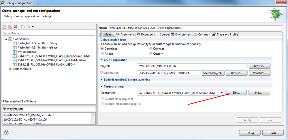

In order to change this feature, please go to CW project main menu -> Run -> Debug Configurations...
In the Debug Configurations window, find Target Settings -> Connection -> Edit...
In the Hardware or Simulator Connection window, find Connection tab and uncheck the box: 'Use Bus Clock as Debug Controller Clock Source', click OK.
In that case, the debug module will use 1MHz IRC clock for BDM communication instead Bus clock.

1,953件の閲覧回数
axhubner
Thanks Radek, it works
