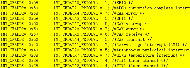

simonliu
Hi Daniel,
     As mentioned above,If I need set the CAN and Port L priority at same time.How do I set INT_CFADDR?The CAN is 0x50,Port L is 0x30. I need set INT_CFADDR = (0x50 & 0x30 )?
5,103 Views
danielmartynek
The INT_CFADDR registers selects 8 vectors out of 128 that are accessible in the 8-byte register window INT_CFDATA0–7. And thus you can't configure CAN and Port L interrupts with just one write to the INT_CFADDR register. You have to configure the interrupts one by one.

simonliu
Hi Daniel,
          I have set the reg for this,but it still doesn't work.
          Is there an example of this part of the project?Tks!
