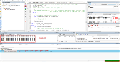

charles_wangw
Hello Radek
Thank you for your feedback. Seems I can read the register to see it is unlocked. But why I still not dump(save) flash out. They are all 0xEE which seems are still locked.
