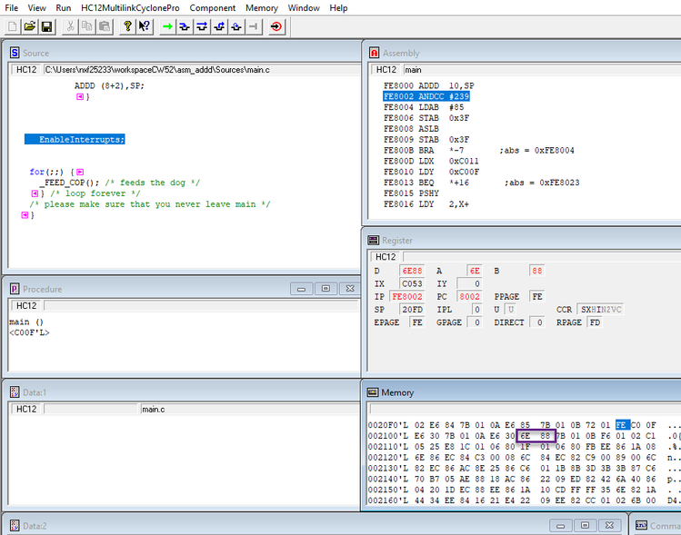

danielmartynek
Hi Robert,
So, (8+2) is an offset to location M which is the SP in this case
M = 0x6E, M+1 = 0x88 which is added to D (A = 0x00, B=0x00).
D = 0x6E88

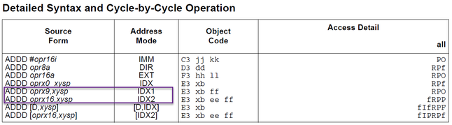

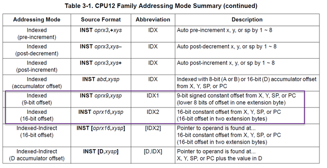

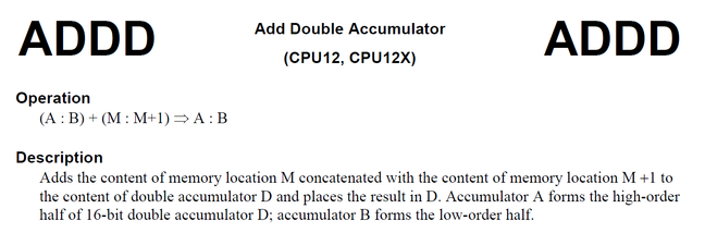

danielmartynek
Hello Robert,
I'm sorry for the delay.
It is explained in the CPU12X reference manual v01.04.
It concatenates the content of M with the content of M+1 and adds it to the accumulator D.
I believe you can test it in CW 5.2, there is a simulator if you don't have any board.

roberthiebert
Senior Contributor I
Hi Daniel,
Got it, and thanks so much for the lesson in debugging. So it looks like I was correct in my original post where I thought that (8+2),SP could be the same as 10,SP. I wonder why the author would chose to do it that way?
