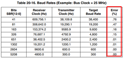

I am a developer developing with XET256 MCU.
I am considering whether I should communicate using SCI or SPI.
I want to use SCI.
I want the SCI Baud Rate to use 500kbps.
Below are the PLL clock settings I set.
Internal bus clock: 32Mhz
VC0 clock frequency: 64Mhz
Reference divider: 1
PLL multiplication factor: 2
PLL post divider: 1
and IREN : 0
I looked at the MC9S12XEP100 Reference Manual Covers MC9S12XE Family datasheet.
I have Table 20-16 on page 742 of the datasheet. I would like to know the formula for calculating the Error (%) value in Baud Rates (Example: Bus Clock = 25 MHz).
Please tell me how to get Baud Rates Error.
And please tell me what the error rate is for 500kbps in my specs.
thanks.

1) Attached...contains also required calculations and formula for UART -  I think it is usable without additional words. (Only change green cells, and button Summarize results)
2) https://community.nxp.com/t5/S12-MagniV-Microcontrollers/S12X-PLL-Filter-Calculator/ta-p/1125313
