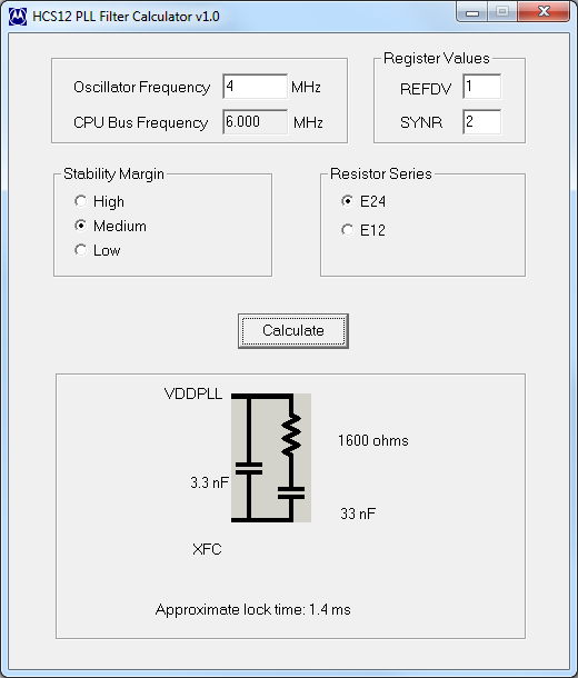

Here are the two utilities which can be used to calculate the following:
- PLL filter component values on HCS12 devices such as MC9S12DP256

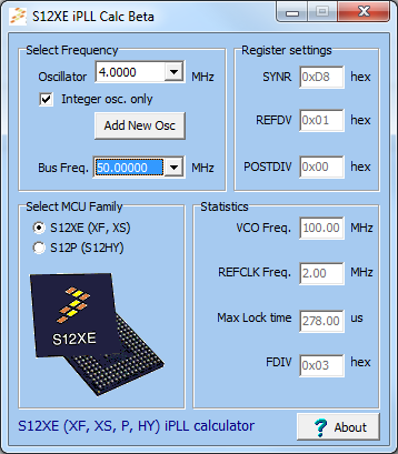

- PLL register values on S12(X) devices such as S12XE, S12XF, S12XS, S12P and S12HY.
Both utilities come with appropriate user manuals in PDF.
