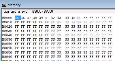

In main program, I'm using Upg_Cmd pointer to get the content in 0x2FE00 (Local paged address 0xBBE00) but always get 0xFF. I checked in BDM debugger interface and the actual content of 0x2FE00 (Local paged address 0xBBE00) is correct and not corrupted, also, Upg_Cmd can be correctly assigned 0xBBE00.
Upg_Cmd= (UINT8 * far) GlobalToLocal(Upg_Cmd_Addr);
cc= *Upg_Cmd++;
When code executed, cc is 0xFF which suppose to be '5'.

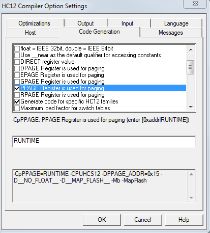

 see attached example project and read the main.c file:
// for space creation see prm file. Search for keyword "NXP support"
// the cons is also added into entries and added feature "volatile" to be sure
//    it is not revomed by optimization. You should check the address in debugger
//    or S19 record to be sure the data is there
// Be sure you are using correct routine to get data from flash :
//     press Alt F7-> Compiler for HCS12 -> Options -> Code generation ->
//           -> Match PPAGE register is used for paging
//     Write Runtime in the cell which appears.
//   ..or write -CpPPAGE=RUNTIME into compiler option
// The compiler command line is also adjusted to be compiler informed we will
// use paged variables. The option "-D__FAR_DATA"  is added into
// the compiler command line (Alt F7->Compiler for HC12 ->
//  ->Add -D__FAR_DATA in the Command Line Arguments)
..or write -CpPPAGE=RUNTIME into compiler option…

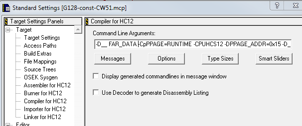

walter_wang
Hi Iama,
Thanks for reply, unfortunately my issue still remains the same after adding these compilor options.

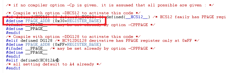

But when I'm trying debugging into assembly codes, especially going through the routine _LOAD_FAR_8, the root cause seems found:
The problem may be caused by wrong PPAGE address defined in datapage.c, it was defined 0x30 as below picture shows, but S12G128 PPAGE register is at 0x15.
This bug in AN4258 based bootloader may cause codes cannot use "* far" or "*__far" to read banked data due to wrong PPAGE address.
After modifying PPAGE_ADDR to correct address 0x15, data at Flash address 0x20000 (banked addr is 0xBBE00) can be read correctly.
Thanks for your support, and it would be good if you can add this finding to AN4258 new revision.
