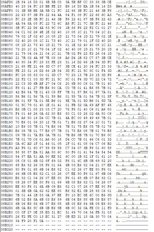

Hi guys,
I have a Bootloader and application files in project with part of S912G128MLL,now i cant erase and write flash with Bootloader.

and this is my erase code in bootloader :
UINT8 PFlash_EraseSector(UINT32 address)
  while((FSTAT & FSTAT_CCIF_MASK) == 0);
  FSTAT = 0x30;
  FCCOBIX = 0x00;
  FCCOB = 0x0A00 | ((address & 0x00080000)>>16);
  FCCOBIX = 0x01;
  FCCOB = (address & 0x0000FFF8);
  FSTAT = 0x80;
  if((FSTAT & (FSTAT_ACCERR_MASK | FSTAT_FPVIOL_MASK)) != 0)
   return FlashEraseError;
  else
   return noErr;
UINT8 PFlash_EraseSectorBySector(UINT32 addr_l, UINT32 addr_h)  // addr_l=0x088000 , addr_h=0x08EFDF
  UINT32 Address;
  UINT8 Error;
  for(Address = addr_l; Address < addr_h; Address += FLASH_SECTOR_SIZE)  // FLASH_SECTOR_SIZE=200
    Error = PFlash_EraseSector(Address);
    if(Error != noErr)
      return(Error);
   return(noErr);
here is main code location
Please tell me where is my wrong
