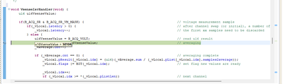

Hello NXP team,
There is a question about PTB1 to measure external voltage, this is my configuration:
TYPE_VSENSE_LIST const vList[] = {
//	ch,          avg ,      latency
	CH_VSENSE0,   10,      12,
	CH_VSENSE1,   10,      12,
	CH_VSENSE2,   10,      12,
	CH_VSENSE3,   10,      12,
	CH_V_PTB1,    10,      12
It seems that the max ADC value of PTB1 voltage reach the full range.
No matter how to adjust the external voltage,The "u16VsenseValue" is aways 50100.
The question is the max value of 16bit ADC should be 65535, I'd like to know  why it cannot reach the value of 65535.
Thanks!
1,906 Views
gumu
Contributor V
I have enabled GAIN and the gain value is 0.7632, 50000 ≈ 65536*0.7632.
Fixed!
