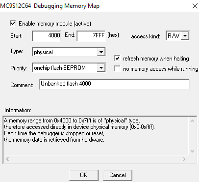

3) When debugging you should set:
4) Do not visualize written part of memory in memory window while E/W because debugger is reading the memory and reading while writing is not allowed.

I would like to ask which part of the flash you want to E/W. If you need only small part then I suggest to select some part of near flash. (4000-4FFF, C000-FFFF) It will solve issue with paging.
