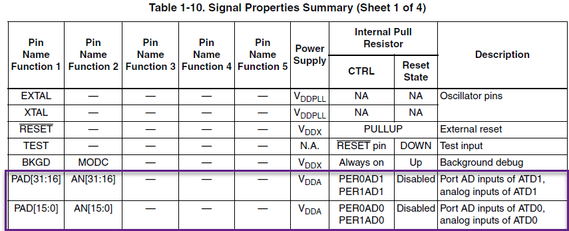

Hello all,
I am using a MC9S12XEP100CAL 112LQFP in a project and am having some issues with the analog to digital converter. I am using ADC0 and have it configured as follows:
- Enable PAD12 through PAD00
- Wrap after converting AN12
- No external trigger, 10 bit resolution, discharge cap before conversion
- Fast flag clear, continue in stop, no external trigger, sequence complete interrupt disabled, compare interrupt disabled
- Right justified data, 16 conversions, no Fifo, no freeze
- 24 cycle sample time, prescale = 2 for 8.3Mhz ATDCLK
At present I have 10K pots connected to all the inputs from the same 5 volt regulated supply. I have a dedicated ground return to all the pots. The conversions seem to work just fine except for one thing. When I turn the pots full travel one way I measure 5 volts to the pin and get an ADC reading of 1023 counts, which is what I would expect. However, when I turn the pots full travel the other way I measure 0 volts to the pin but get an ADC reading of between 32 and 33 counts, not the 0 counts that I would expect. All pots behave exactly the same way. There is no potential difference between the analog ground and the system ground. Does anyone have any suggestions as to what my problem might be?
Robert

I had considered the possibility of me enabling the pullups unintentionally last night, but it was getting late and my brain was ceasing to function so this morning I had another look at the listing file. Sure enough. I found some old code that I had forgotten to remove in my GPIO initialization macro that enabled all the pullups. I removed the code and re-assembled it. Voila, the ADC works as it should.
Thanks so much for your help.

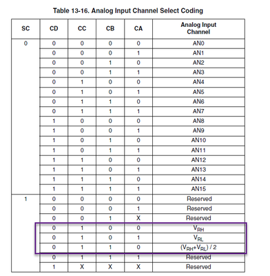

2) you use continous conversion. Does it mean you wait for SCF then reads result from the chanels which are also converted in parallel?
If you want to get result in some time it is better to perform single multi conversion started by writing to ATDCTL5
3) However, it looks like you start it once to continous conversion, wait and read the data,...then you only wait for SCF and then read the data.

What I am trying to accomplish is to have all ATD channels converted as fast as possible so I can sample them all together every time through the main loop. I don't know how much time it takes to do the conversion set, and when I first wrote the code I had no idea how much time it would take to complete one loop in my program. Since then, I have a counter at the end of my main loop and it looks like it runs at about 11,525 loops per second right now. I expect that number will drop as the processor gets more tasks, but I doubt that it would drop much lower than about 5000 loops per second or so. I really only need to sample all the ATD channels a maximum of about 85 times per second so I probably have lots of room to change things in the set up .
The way I have the code written now I call start "START_ATD0" macro, then convert the results to user units only once before I enter the main loop. This gives me the present state of all the sensors. Then I call the "RUN_ATD0" macro every time through the main loop to keep them all updated.
Given what I am trying to do, and the time frame in which I would like to do it, have you any suggestions for changes to my code that I could try?

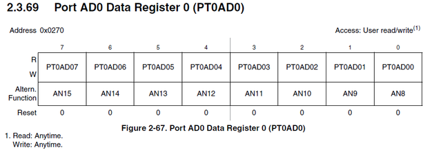

movw #$1FFF,PT0AD0 ; Load Port AD0 Data Registers PT0AD0:PT1AD0
; with %0001111111111111 (General Purpose I/Os on pins 15,14,13
; ATD on pins 12,11,10,9,8,7,6,5,4,3,2,1,0)
;(Registers are %00000000 out of reset)

I just did another check. With the external pots disconnected I checked the state of the ATD pins on the board connector. They all read between 4.97 and 5.01 volts so it looks like somehow those pins are being pulled up. So far I haven't found anything on the board that might do this.
Robert
5,754 Views
roberthiebert
Senior Contributor I
Hi all,
I'm still trying to figure this thing out. I really don't know if it is a hardware issue, or if I have something wrong in my initialization. As I mentioned before, with nothing connected to any of the analog pins, with the exceptions of Ch0 and Ch7, I am reading 5 or almost 5 volts to ground. Either the dedicated sensor return ground or system ground, same result. Can anyone tell me if this is normal or not?

Still working on this issue. Everything points to the pullups being enabled. I did a test. I disconnected all the external pots from the ADC inputs and checked to see if I had current to ground. I did. Then I placed a 1k resistor in series with my Fluke 187 to ground. It read 118uA. Assuming there is a pullup to 5 volts this works out to 41.372K value for the pullup. I believe the internal pullups are supposed to be ~50K, so this indicates that my theory is probably correct.
I have PT0AD0 set to $1FFF (GPIO pins15...13, ATD pins 12...0)
I have DDR0AD0 set to $0000 (all pins inputs)
I have PER0AD0 set to $E000 (pullups enabled pins15...13, disabled pins 12...0)
Is it possible I have a bad chip? I have two assembled boards, both behave exactly the same, so both would have to be bad. Is this probable?

danielmartynek
Hi Robert,
The measurement is interesting, it indeed seems like there are internal pull-ups enabled.
However, they are disabled by default.
You don't even have to configure the PIM module to use the pins for ADC0.
So maybe you enabled them unintentionally.
You wrote:
I have PT0AD0 set to $1FFF (GPIO pins15...13, ATD pins 12...0).
PTxADx are Data registers, they can be read in GPIO Input mode and written in GPIO Output mode.
Please note that PT0AD0 is for AN8 - AN15 and PT1AD0 for AN0 - AN7, this can be confusing.
Have you tried a simple test code like the attached one?
BR, Daniel

lama
Hmmm, 32 is high value I have never met with. It smells like the channel is influenced from other channels or dynamic parameters does not fit speed of measurement.
Could please:
1) Measure internal references
2) decrease atd clock
3) increase sample period
4) make analysis for possible injection currents from other channels. (sett all other chanel so GND)
perform single measurement.
.... and now I am going to look at the code....
