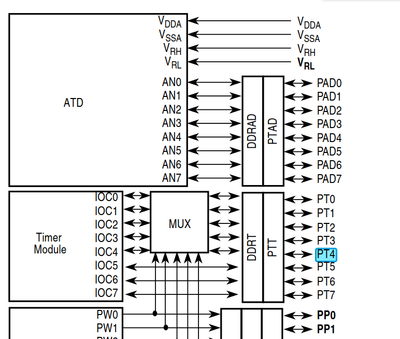

That doesn't appear to be the problem. I tried applying a 5 volt 100mS square wave to PT4 and PTM4 is still not toggling. Have I got my set up correct?

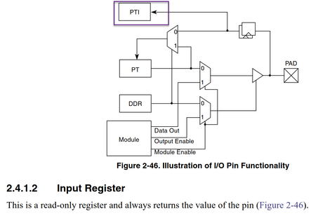

I'm a bit confused about the PWM and TIM functions and which pins they are assigned to. Should I be checking the PTIP register, the PTIT register or both. At this point it looks like IOC4 is not generating an interrupt but it definitely has a 5 volt square wave signal to the IOC4 pin. I discovered this by placing a break point in the ISR with the debugger, but the program never got there.

I'm sorry, it is PTIT.

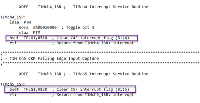

There is one issue in the code I overlooked.
It is the BSET instruction used to clear the flags.
BSET does read-modify-write operation at the register, which clears every flag that is set in the register.
It is explained here:
https://www.nxp.com/docs/en/application-note/AN2554.pdf
Can you test it?

Thanks for that link. I studied it and think I have made the correct changes to my program (attached). Unfortunately I still can't get either IOC channel or IRQ to trigger their respective ISRs.

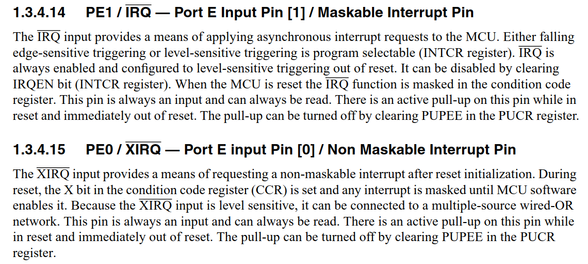

I'm still not quite clear on the IRQ channels. It is my understanding that IRQ (PE1) is set to falling edge capture only if IRQCR, IRQE is set to 1. To enable PE1 does IRQCR, IRQEN have to be set to 1 as well? I tried that and still didn't get it to work.
Is PE0 a separate IRQ channel and if so what triggers it, Falling edge, Rising edge or Hi or Lo level? The manual doesn't give me much information on this, or at least I can't find it if it does.

I believe this is well explained here:
https://www.nxp.com/docs/en/data-sheet/MC9S12C128V1.pdf

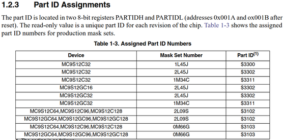

Can you double-check the part ID in the PARTIDH and PARTIDL registers?

Thanks for the clarification on IRQ and XIRQ. I think I understand it now. I have experimented with use of the pullup but I still can't get it, or IOC4 or IOC5 to trigger their respective ISRs.
PARTIDH is $31, PARTIDL is $03. What does that tell you?
Robert

Update. After trying just about every combination of everything I could think of I finally got the test program to work. I think the key issue was the way I was clearing the flags. As for the IRQ, I didn't notice that the pullups for Port E are set after reset. I used an external pullup in my other program so that kind of messed me up. I've attached my latest test program. Now I have to see if I can get them to work in my main program, but at least I have this working for an example.

Also, The PTIP register will give you the state of the pin in any mode.
