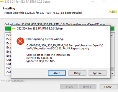

This statement means that the installation is unsuccessful on Windows PC due to the same error that mentioned earlier but after the unsuccessful installation
This looks to me like admin right issues at your PC. I expect that this has nothing to do with our installation package as the error clearly state there is issue with opening file for writing.

HaMun
Thank you for your reply!
I’ve attempted the installation on four different laptops so far, including three running Windows and one running Ubuntu with Wine. One of these is my personal laptop, where I ran the installer (S32SDK_S32_PA_RTM_3.0.3.exe) as an administrator. Unfortunately, I encountered the same error on all of them.
As you mentioned, when I tried running it on S32DS for Power Architecture on my Ubuntu laptop, I ran into missing headers again, so I understand that the SDK needs to be properly installed. However, it seems impossible to complete the installation successfully.
Could you please try running the installer on your end and confirm if it works? Or do you have any other suggestions or workarounds to resolve this issue? This is really urgent.

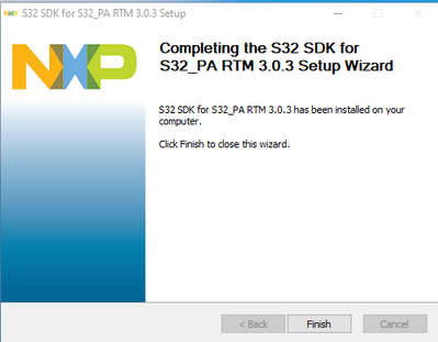

petervlna
I have just downloaded and installed the 3.0.3 version on my PC with no issues on Win10.
I did nothing special except I have installed it as administrator.
All this issue on your side looks to me tied up to your PC environment.
There is really nothing I can do here to help you will installation as for me it is working out of the box.

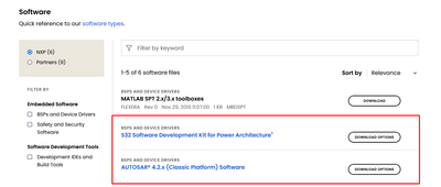

You can for example use some reference codes available in S32DS - RTD 3.0.0 package:
https://www.nxp.com/design/design-center/software/development-software/s32-sdk/s32-software-developm...
The documentation are included in the example code and RTD package.
Also the ENET module is described in reference manual:Chapter 61 Ethernet MAC (ENET)
especially 61.6 Functional description.
Such are also present in MCAL drivers:
https://www.nxp.com/products/S32R2X

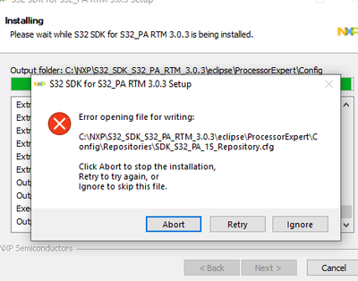

Last week I tried to install S32SDK but it gave some errors during the installation on Windows. I am still getting the same error. I archived the exe file to access the examples but the Cpu.h file is missing in the folder of enet_ping example which is being called in main.c.
 I would appreciate your help!

petervlna
Hmm, this looks to me like instalation for Tresos.
Are you doing update site.zip in S32DS?
Please have a look at the tutorials to proceed with installation.

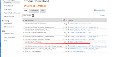

Now, as you mentioned in your first answer, I tried to install S32SDK (S32SDK_S32_PA_RTM_3.0.3.exe) (https://nxp.flexnetoperations.com/control/frse/download?element=11060487) to access the enet_ping example for S32R274. But the installation does not work. I could access to the examples without the installation but the only thing is missing is Cpu.h file. Can you provide that for me?
Best,
Hadi
6,046 Views
petervlna
What should I imagine under this statement? Could you describe the issue closer?

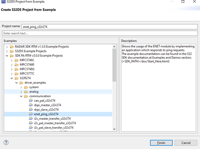

Ok, not sure either. So you can create the example in S32DS and build it, but missing Cpu.h?
Did you generate mex configuration before compiling?

This statement means that the installation is unsuccessful on Windows PC due to the same error that mentioned earlier but after the unsuccessful installation, a folder is created which is extracted info from exe file that exist all the files, documentations, and examples. Since I am running on my Ubunutu Laptop S32DS for Power Architecture without issue, I tried to run the ENET ping example existed in the extracted folder on my S32DS for PA. But, as mentioned,  the Cpu.h is missing in the extracted folder from exe file of S32SDK. I assume that this can be generated when S32SDK can be installed properly which in my case does not, due to the last reason. So what should I do? in my S32DS for PA on my Ubuntu, there are not any examples for S32R274, that's why I need the Cpu.h file or I need to install the S32DSK properly. What should we proceed?
The following is the main file of ENET ping example but the folder does not include the Cpu.h header file.
