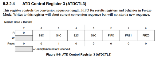

In my program I want to read 5 channels in 8 bit resolution at different points in my program. When I test it on a test program I set an output when the conversion starts, and clear it when the conversion is finished for each channel in succession. Then I record this on my digital signal analyzer to see how long each channel conversion takes. The conversion on Ch0 takes 7.41uS, which is about what I expected. However, each of the next channels take  6uS longer than the previous one.
Ch0 - 7.41uS, Ch1 - 13.42uS, Ch2 - 19.41uS, Ch3 - 25.45uS, ch4 - 31.41uS, Ch5 - 37.41uS.
I'm assuming I have done something wrong in my ADC set up but I can't seem to find it. Any suggestions would be appreciated.

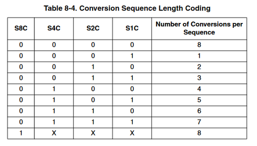

Hi @roberthiebert,
I just briefly checked the code, it seems you selected 8 conversions in a sequence.
movb #$00,ATDCTL3 ; %00010000, 1 conversion
ATDCTL3 = 0x00

Hi Daniel,
Thanks so much for your response. Indeed, that was a typo error on my part. I changed to ATDCTL3 = 0x10. Now the program hangs at line 275.
brclr ATDSTAT1,#%00000100*. The conversion complete flag for channel 2 doesn't seem to be setting for some reason.

Hi Robert,
It should be 0x08 for 1 conversion though.

Hi Daniel,
Oh my, another stupid error on my part. I changed ATDCTL3 to 0x08 but now my program just does the conversion for channel 0 then stalls at line 268, waiting for the conversion complete flag. There must be something else involved as well.
