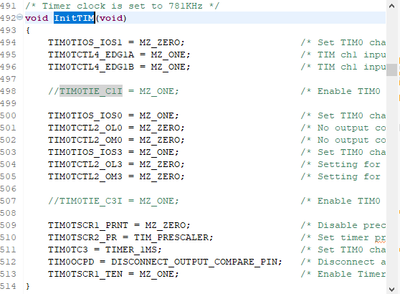

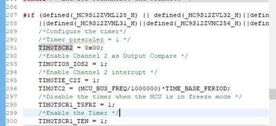

Hi, I'm using S12ZVML64 MCU as LIN slave for Motor Control. I've used NXP Lin Stack. Here the API l_sys_init(); initializes the following
But in our application code there are certain registers that are required for the functionality of motor control.
If I keep the line number 498 and 507 commented Lin works properly. But If I uncomment line number 498 and line number 507. the code shows the following
Please let me know how to resolve this.

Hello @itsnewforme,
This is related to this question:
https://community.nxp.com/t5/S12-MagniV-Microcontrollers/Lin-Initialization-For-S12ZVML64/td-p/15701...
Can you use another channel for the motor control?
