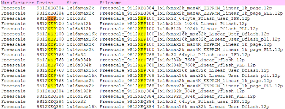

But, I can't configuring the development environment.
How to debug it ?
I try all what I do.
And I have Cyclone FX.
So, I try to debug it.
However I can't know what algorithm I use.
I know it's MC9S12XEP100MAL.
But, I can't understand size.
Please Help me.
I wanna debug my kitvalvecntlevm board.

I suppose you use CodeWarrior v5.1 (or v5.2) for S12(X) MCUs.
There is some issue with the new products of P&E Micro such as Multilink Universal FX and Cyclone FX
Maybe it would be good to contact P&E MIcro support and ask for a device patch:
P&E Microcomputer Systems: Over 30 years as an Industry leader in Embedded Systems Development Tools...
Also, ensure the jumpers on the board are correctly set -> JP1 in 1-2 position (watchdog disabled).
