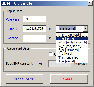

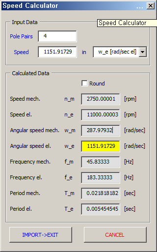

I tried PMSM FOC with attach file
So, I need kindly mention of Configuration S12ZVM_PMSMFOC_appcfonfig.xls
Specially, Please look below Picture
i did attach project file

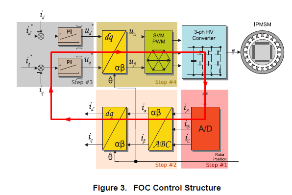

Hi Joseph,
In normal run, the motor is driven by two closed loops.
The fast loop is executed typically every 100us and we call it the Current loop.
The slow loop is executed typically every 1ms and we call it the Speed loop.
The Current loop:
From Current loop bandwidth and Current loop attenuation parameters are recalculated PI regulators parameters.
The typical value for Current loop bandwidth is 200~250Hz and for Current loop attenuation it is 0.8~0.9.
For more details, please look at application note AN5135:
http://www.nxp.com/files/microcontrollers/doc/app_note/AN5135.pdf
or look at theory by searching something like “close loop feedback control”.
I hope it helps you.
