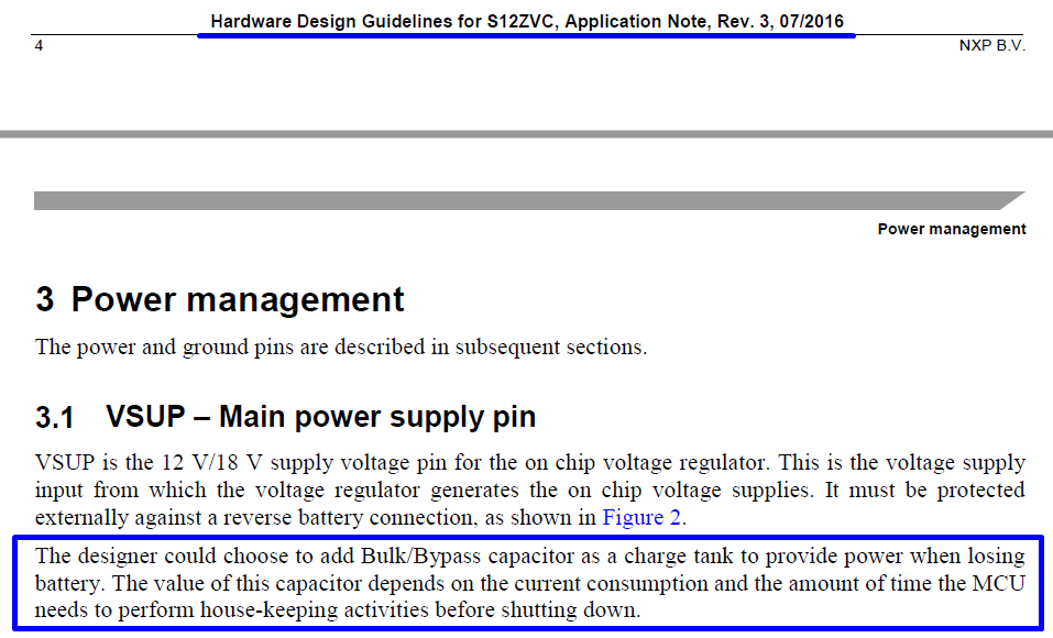

As Edward already mentioned, the BATS module can trigger a interrupt when VSUP drops below a certain voltage level.
The time between this BATS warning and LVR depends on the power consumption and the VSUP bulk cap.
The NVM timing characteristics can be found in Appending K, S12ZVC RM rev2.
BR, Daniel
