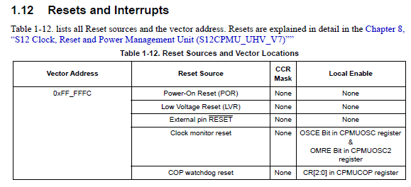

How to soft restart the S12ZVC? Not watch dog.

The MCU has only the reset sources shows below.
There is no SW reset. Triggering COP is the recommended way.
You could use a GPIO connected to the reset pin to trigger the External pin RESET by driving the GPIO low.
