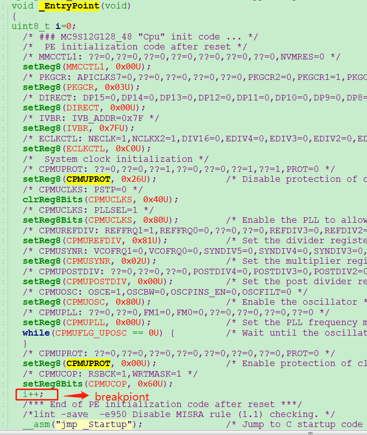

boot's cop is disable,app's wd is enable.
Question1.when flash the bootwithapp to mcu ,but debug found that the cop counld not wrok,Why?

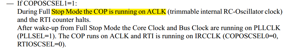

Question2. when the cop's clock was ACLK,how to disable the cop ?

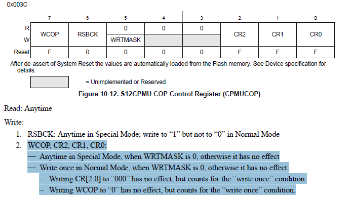

The COP is driven by CPMUCOP register.
In special mode, you may write CPMUCOP register without restriction. Any write will restart COP timeout period.
In normal mode, you may write CPMUCOP register just once. If bootloader writes CR[2:0] as “000”, the application cannot change it without MCU restart.
Please check the complete CPMUCOP write conditions in RM.

玉敏111田
Thanks .I have read the data sheet .And when I debug the EntryPoint Function with the breakpoint ,I found that WRTMASK was 0 rather than 1!
