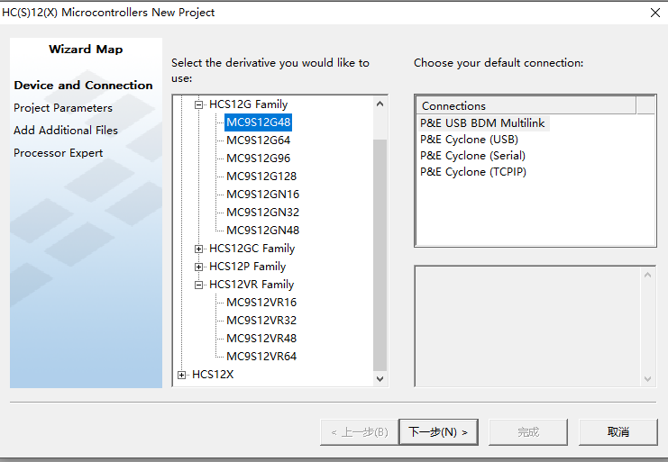

How to create the project use S12VRP48 in codewarrior v5.1

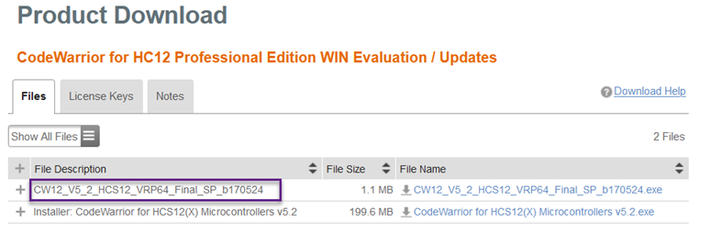

I’m very sorry for the delayed response,
There is a CW5.2 service pack available for the S12VRP MCU,
Please go to:
nxp.com
My account
Software Licensing and Support
Software accounts
NXP Software
CodeWarrior Development Tool
CodeWarrior for HC12 Professional Edition
You should see this:
Thank you,

常瓦姚
Doesn't anybody have this problem?
