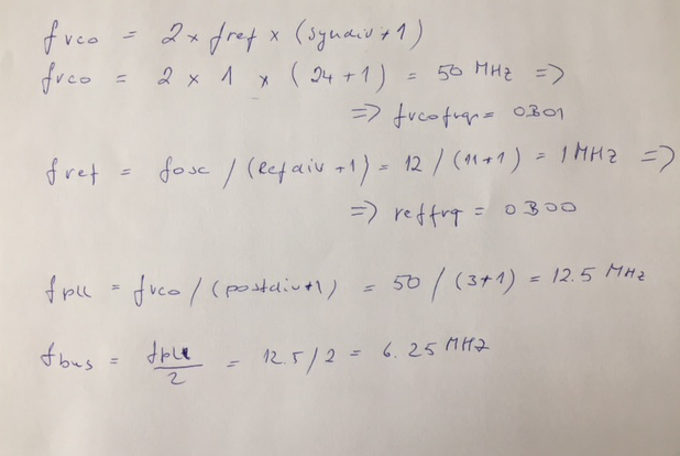

// fref = 1MHz, fVCO = 50MHz, fPLL = 12.5MHz
CPMUREFDIV = 0x0B; // fref = fosc/(refdiv+1) = 12 / (11 + 1) = 1MHz 00_00_1011
CPMUSYNR = 0x58; // fVCO = 2 * fref * (SYNDIV + 1) = 2 * (24+1) = 50MHz 01_011000
CPMUPOSTDIV = 0x03; //fPLL = fVCO / (POSTDIV + 1) = 50 / 4 = 12.5MHz 000_00011
fref = 1MHz, fVCO = 50MHz, fPLL = 12.5MHz can work on CAN-bus 250Kbps or not?
Can you give me some advice?

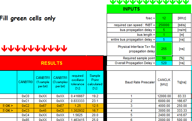

I am sorry I am not able to answer. I am not sure I have missed something but we have to think about different clocks:
1) BUSCLK frequency of the bus.
   What value of BUSCLK you want to have?
2) OSCCLK frequency of the oscillator from which the busclk is derived. (12MHz in your case)
3) CANCLK - frequency of input clocks to a CAN module. The CANCLK can be OSCCLK or BUSCLK.
If the CANCLK is derived directly from OSCCLK the busclk does not influence CANCLK.
The results are highlighted. The only problem I see sample point. If it suits to you then it is OK.
I can see you use ATD and SCI in your example without any info about busclk from which the clock for these peripherals are derived. I have look at your SCI setup and you really use 6.25MHz busclk.
Now there are two ways:
1) Either select new busclk and adjust clock setup for SCI and ATD
2) or to use original clock setup for ATD and SCI peripherals and try to trim busclk to 6.25MHz.
If I assume item 2, then your original setup is OK and I suppose you do not want to change anything in the ATD and SCI peripheral setup, so:
OSC[MHz]SYNDIVVCOFRQREFDIVREFFRQPOSTDIVfreffvcofPLLfvco/freffbus
12241110315012.5506.25

  // PLL setup 16 MHz BUSCLK from 4 MHz
  // expected frequency after lose of OSC, PEE, PBE:
  //  - fbus= fpll/2= 1/4MHz/2 = 125 kHz till locked then
  //  - fbus= fpll/2= 2*fref*(syndiv+1)/(postdiv + 1)/2 = 2*1*25/(3+1)/2=6.25MHz
  CPMUSYNR = 0x58;      // 0B01_0x18
  CPMUREFDIV = 0x0B;  //  0B00_0x0B
  CPMUPOSTDIV = 0x03;

I see no problem with the current setup. Everything is working correctly. If there are no special expectations for calculations or processing tasks then current setup is OK.
The only thing I HAVE TO correct is the excel sheet I sent to you. There is a mistake in the sample point calculation. I have corrected it in this version CAN_setup6.zip.

lama
If you decided to use 60% from other results then OK.
Only comment: A good general rule is to set the sample point above 80%. Based on the experiences of the automotive industry, the selected sample point should be near the 80% value.
CANBTR0
CANBTR1 (1 sample per bit)
CANBTR1 (3 samples per bit)
required oscillator tolerance [%]
Sample Point
calculated
!! OK >
0x82
0x2B
0xAB
0.726392
0.9
!! OK >
0x43
0x18
0x98
0.645161
0.9
!! OK >
0x45
0x14
0x94
0.970874
0.8
The setup:

aaronlee
Contributor V
Hi Ladislav,
I only see 2 rows show "OK". What's wrong?
I will modify my code by following your reply later. Thank you.
Aaron
8,569件の閲覧回数
lama
change sample point (input parameter) in the cell $I$22 to 80% and results will change.
best regards,
Ladislav

aaronlee
Contributor V
Hi Ladislav,
My mistake. Thanks for your reply.
I select following parameter.
But my code(as attachment) can not sent any CAN-bus data. Please help.

lama
 the best clock and clock stability you get if you do not supply clock from PLL but directly from the oscillator.
in this case you should select proper oscillator frequency for CAN bit timing and then set CLKSRC bit in the CANCTL1 to 0.
register CANCTL1:
bit CLKSRC: MSCAN Clock Source — This bit defines the clock source for the MSCAN module (only for systems with a clock
generation module; Section 18.4.3.2, “Clock System,” and Section Figure 18-43., “MSCAN Clocking Scheme,”).
0 MSCAN clock source is the oscillator clock
1 MSCAN clock source is the bus clock
However, if you are still decided to use fbus as a source clock for can then I would like to be sure you want to use
fbus = 6.25MHz because you set fpll to 12.5MHz in your setup. If there is anything wrong then I would like to ask you to provide busclk=fbus you want to set.
Finally, when I have your inputs, I will send you and code example.
For CAN setup you can use attached excel sheet.
Ladislav

Contributor V
Hi Ladislav,
I only know the parameter of marked (12, 250000 & 10).
I want to use CLKSRC=0 (MSCAN clock source is the oscillator clock) & internal physical interface in S12ZVC.
Aaron

  //                  then  fpll = 2 * fref *(syndiv+1) / (postdiv + 1) =
  //                             = 2 * 1MHz *(24    +1) / (3       + 1) =
  //                             = 50 / 4 = 12.5MHz
  //                        fbus = fpll / 6.25MHz
  Delay( 1000 );    //delay in order to see default bus frequency on ECLK output
