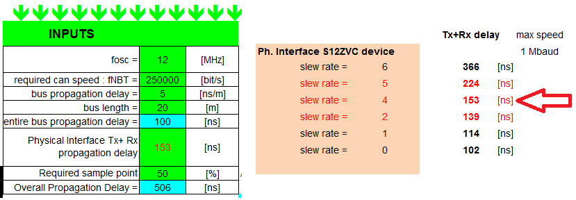

I wrote CAN_Init() & CANPHY_Init() as following. Do you have any recommendations ?

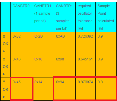

If you decided to use 60% from other results then OK.
Only comment: A good general rule is to set the sample point above 80%. Based on the experiences of the automotive industry, the selected sample point should be near the 80% value.
CANBTR0
CANBTR1 (1 sample per bit)
CANBTR1 (3 samples per bit)
required oscillator tolerance [%]
Sample Point
calculated
!! OK >
0x82
0x2B
0xAB
0.726392
0.9
!! OK >
0x43
0x18
0x98
0.645161
0.9
!! OK >
0x45
0x14
0x94
0.970874
0.8

aaronlee
Contributor V
Hi Ladislav,
I only see 2 rows show "OK". What's wrong?
I will modify my code by following your reply later. Thank you.
Aaron
8,742 Views
lama
change sample point (input parameter) in the cell $I$22 to 80% and results will change.
best regards,
Ladislav
8,742 Views

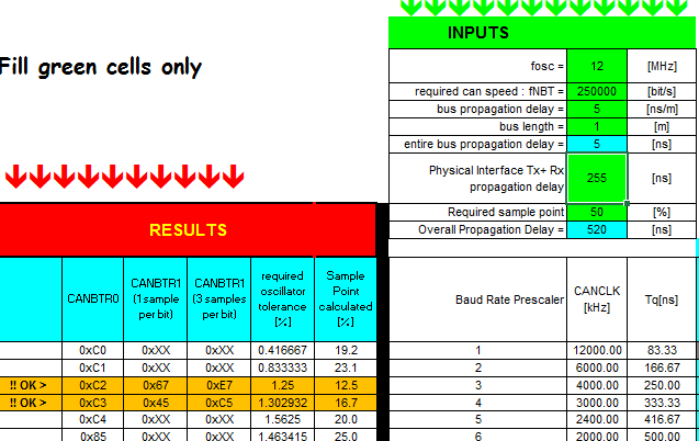

 the best clock and clock stability you get if you do not supply clock from PLL but directly from the oscillator.
in this case you should select proper oscillator frequency for CAN bit timing and then set CLKSRC bit in the CANCTL1 to 0.
register CANCTL1:
bit CLKSRC: MSCAN Clock Source — This bit defines the clock source for the MSCAN module (only for systems with a clock
generation module; Section 18.4.3.2, “Clock System,” and Section Figure 18-43., “MSCAN Clocking Scheme,”).
0 MSCAN clock source is the oscillator clock
1 MSCAN clock source is the bus clock
However, if you are still decided to use fbus as a source clock for can then I would like to be sure you want to use
fbus = 6.25MHz because you set fpll to 12.5MHz in your setup. If there is anything wrong then I would like to ask you to provide busclk=fbus you want to set.
Finally, when I have your inputs, I will send you and code example.
For CAN setup you can use attached excel sheet.

Contributor V
Hi Ladislav,
I only know the parameter of marked (12, 250000 & 10).
I want to use CLKSRC=0 (MSCAN clock source is the oscillator clock) & internal physical interface in S12ZVC.
Aaron
