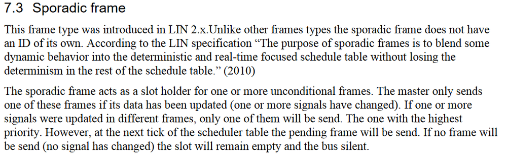

With use of sporadic frames,
Sporadic_frames
       SporadicControlFrame: frame_1, frame_2, frame_3;
table_1
       SporadicControlFrame       50ms;
This way, the LinStack will check every 50ms if any of the signals in the corresponding frames (frame_1, frame_2, frame_3) is updated and it will send the frame.
Note that when the checking process happens, the highest priority frame will be sent.

I guess you want to use the second way.

I really appreciate you for your powerful support. Now I am very clear about what I need to do next. I will use the the sporadic to realize my requirement in code.
