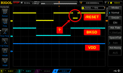

For active mode trying issuing BACKGROUND command. This should pause CPU since it is running in NS mode. Debuggers use that command to pause on user request.
But the best would be to fix issue you posted previously. Without that spurious /RESET pulse you would enter active BDM just with the help of /REST and BKGD pins. Perhaps you have some supervisor circuit with built in watchdog reset? Some low voltage detect circuits sense not only power pin, but as well /RESET pin, it could be something like that in your case.

You're right, but it may was an error myself that i opened up another threat to handle that reset problem. It turned out that an external watchdog-device has added the "small" reset pulses. This device expects high/low pulses from the MC9S12 to reset it's watchdog, which does not come when i brought the device into special mode. But shortly it resets the MPU back into normal mode. The reason why the reset-pulse is weaker/smaller than the one from the BDM-interface is that it is routed over a 4,7k resistor to the pin. So the watchdog was able to drag down the level, but not fully to ground.
Now that i found how to fix this (by disabling that device) everything works like expected.

I've played around with TCL-Interpreter and an DSO attached to RESET, BKGD and VDD. I can set RESET to LOW using "pinSet BKGD=L" and also to HIGH with "pinSet BKGD=H". This does not work with power and only half with RESET. When i tell "pinSet RST=L", the pin goes to 0V, but a "pinSet RST=H" gives an errormessage:
% pinSet RST=L
BDM status => Ackn, Speed-sync, Vpp-Off, Vdd-External, RSTO=0, Reset, CFVx-running
:pinSet PIN_RESET_LOW|
% pinSet RST=H
:pinSet PIN_RESET_??|
Strange, eh?
And also all kind of RESET methods in TCL results in the same pulses:
See that extra-reset-pulse? Why is it? Where does it come from? And why has it that strange amplitude? It will definitively return the chip into "Normal Single Chip Mode".
When i pull down both, RESET and BKGD and then release RESET (leaving BKGD down) the RESET constantly produces this pulses until i also release BKGD:
Could it be that an internal reset causes the RESET-Pin to reflect this? So something in the chip will reset until the "Normal Single Chip Mode" is reached? Is that possible without software? Some kind of protection to prevent sombody looking into the system?
This is the reason why all my efforts fail. 
