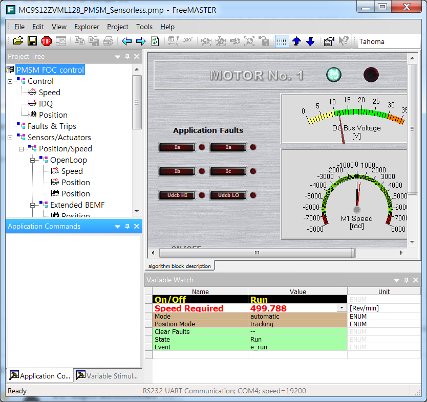

I had a EVMKit (MTRCKTBNZVM128 )
I did load S.W (FOC Sensorless) EVM Kit with Code warrior and Starting Program Freemaster
So I did well run motor on EVM-Kit.
But i didn`t find MCAT Page

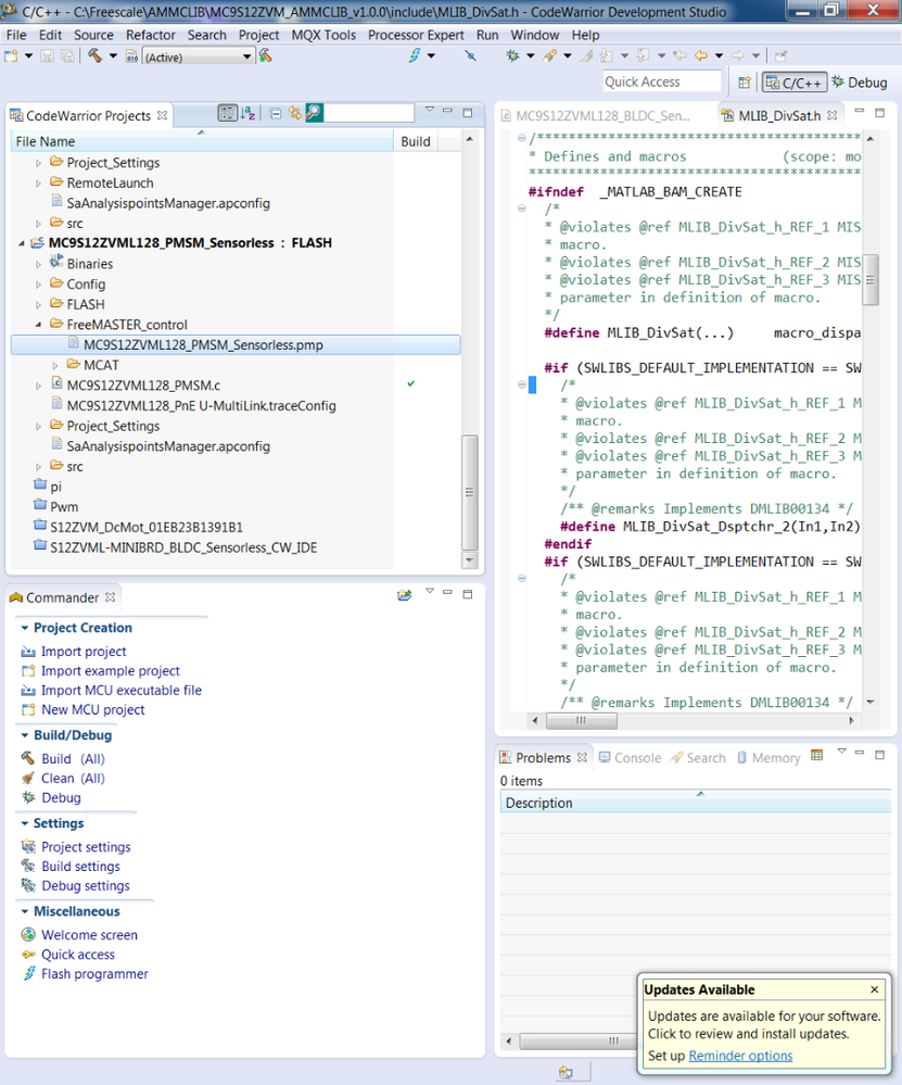

Hello RadekS​
I found your answer(this ticket) about MCAT using S12ZVM.
However I could not find the attached code that was related with MCAT.(you removed that code....)
And as AN5135, it shows MCAT for PMSM using S12ZVM.
However AN5135SW did not contain the MCAT application…
Could you check this reason?
Because my customer asked same thing, the wish to use MCAT but they could not find MCAT using S12ZVM…
Thank you.

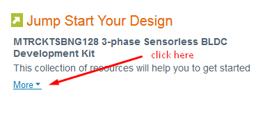

As I wrote, please go to http://www.nxp.com/products/software-and-tools/run-time-software/automotive-software-and-tools/motor...
After that please click on “MTRCKTSPNZVM128: 3-phase Sensorless PMSM Development Kit with S12 MagniV MC9S12ZVML128 MCU” motor control kit link.
The appropriate design documents and software might be downloaded when you unfold this list under “More” link like on picture below:
I just downloaded MTRCKTSPNZVM128 Software and check that it contains MCAT as part of FreeMaster project.
I hope it helps you.

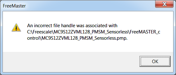

But I can`t run a Freemaster
When the Freemaster file click then  show below box
Can help me?
