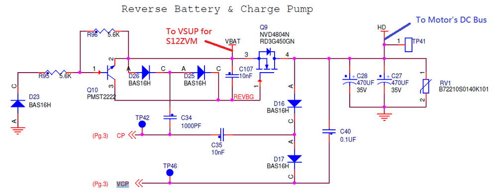

RadekS
Hi Dusty,
In fact, the GDU module is designed to work only up to 20V. We could let it run beyond that limit (up to 26V), but only for limited amount of time (one hour during whole MCU lifetime).
The MCU may survive 40V, but only during the short time (low dump pulse 400ms).
Could you please specify your power supply voltage?
If this DC bus voltage is higher than power supply voltage, it is clear that it is somehow generated voltage. In some cases, the bus voltage may be generated by the motor during rapid slow down (The kinetic energy is transformed into voltage). In that case, we could limit slow down a slope or we could add additional FET transistor with power resistor between DC bus lines and switch ON in the case of an overvoltage.
The power resistor will waste excess energy.
Here is example of that connection (brake chopper circuit):
If the power supply is in the operational range, all settings are correct and the motor starts or rotates on stable speed, there isn't any reason for DC bus overvoltage.
I hope it helps you.
Radek

dustyko
Hi Radek :
Thank you for all your assistance !!
I work this motor in a DC 12V system.
It is a automotive HVAC application and we add a load on this motor.
S12ZVM is into over voltage protection when I drive this motor to 3000 RPM , the power supply shows the power is about 12V , 13A.
The ramp up speed is about 100 RPM/s , it should be a slow ramp up speed.
It seems has a high voltage in the DC bus  when I drive this motor to high speed.
The power path is as below , I want to do some thing to resolve this problem.
Do you have any idea ?
