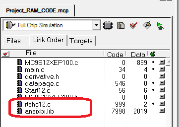

Change the link order so the linker now prefers to uses the source file instead of the ANSI library:
Build the project and check the map file - now both isrVapi and _LINC are located in RAM_CODE section.
