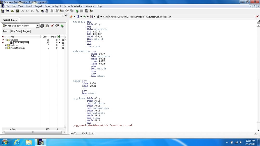

Was hoping someone could help me....I'm having trouble getting my multiplication loop working. I have to perform a check to see if the number is out of range (0-255) and if it is branch to either set_zero or set_ff. I'm storing the input variables in a reg x I have in memory. the two numbers are both positive, but blo flag keeps kicking in. the numbers are loading out of memory right. I think it has something to do with the fact that the result of the operation is a 16bit number, stored in the d reg. I tried adding an l in front of the blo, for long word, but that didn't help. all the other functions work as expected. If anyone has any idea, I'd really appreciate it.

what about:
;_______________________________________________________________________________
; variable/data section
MY_EXTENDED_RAM: SECTION
xa         ds.b 1     ; input variable
xb         ds.b 1     ; input variable
xc         ds.b 1     ; result
ov_f       ds.b 1   ; overflow flag for multiplication; result is > 255
z_f        ds.b 1     ; zero flag for multiplication
MyCode:     SECTION       ; code section
main:                     ; routine is called after power on reset
Entry:
      LDS   #$F00         ; set STACK; reset status: RAM is placed 800~FFF
      MOVB  #0,xa           ; innitialize variables to be multiplied
      MOVB  #0,xb           ;
MAINLOOP:
      LDAA xa                   ; prepare parameteres for sending to function
      LDAB xb
      XGDX                       ; X<=>D; as you wrote you store a,b in X
      JSR multiply
      INC  xa                     ; modify inputs
      INC  xb
      JMP MAINLOOP      ;
multiply:
      CLR z_f                    ; clear flags
      CLR ov_f
      XGDX                        ; X<=>D
      MUL                          ; multiply
      STD  xc                     ; store result
                                         ; test result for given conditions and set flags
      TBEQ D,zero           ; result is zero -> go to "zero" for processing
      TBNE A,overflow     ; result>255     -> go to "overflow" for processing
      RTS                           ; return
zero:
      MOVB #1,z_f         ; set ctm's zero flag
      RTS
overflow:
      MOVB #1,ov_f        ; set ctm's overflow flag
      RTS

and the operation is not triggering the c flag, the number is well withing range of 64k.

1. MUL does unsigned multiply
2.C flag has nothing to do with the "sign" of result.
3. Sign of 16bit result is bit15 of result, not bit7, which MUL copies to C.

(What the beep you are using picture to show text? )
1. there's no BLO flag, please use correct terminology
2. You should download CPU12 reference manual. 6.7 Glossary explains each instruction in detail. MUL instruction changes only C flag. MUL makes bit 7 of result reg D(B) copied to C flag.

jackrichey
