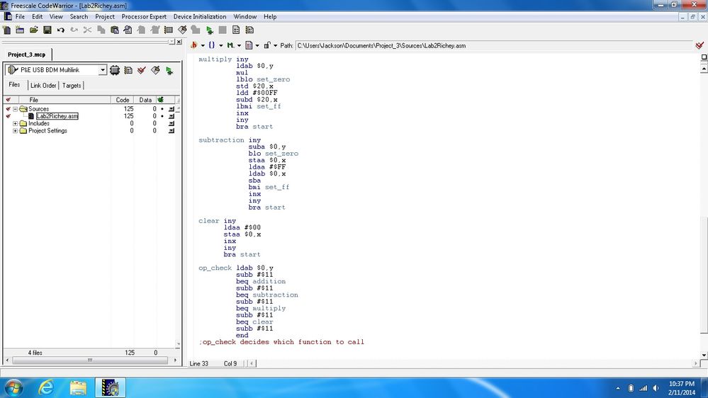

Was hoping someone could help me....I'm having trouble getting my multiplication loop working. I have to perform a check to see if the number is out of range (0-255) and if it is branch to either set_zero or set_ff. I'm storing the input variables in a reg x I have in memory. the two numbers are both positive, but blo flag keeps kicking in. the numbers are loading out of memory right. I think it has something to do with the fact that the result of the operation is a 16bit number, stored in the d reg. I tried adding an l in front of the blo, for long word, but that didn't help. all the other functions work as expected. If anyone has any idea, I'd really appreciate it.

and the operation is not triggering the c flag, the number is well withing range of 64k.

1. MUL does unsigned multiply
2.C flag has nothing to do with the "sign" of result.
3. Sign of 16bit result is bit15 of result, not bit7, which MUL copies to C.

(What the beep you are using picture to show text? )
1. there's no BLO flag, please use correct terminology
2. You should download CPU12 reference manual. 6.7 Glossary explains each instruction in detail. MUL instruction changes only C flag. MUL makes bit 7 of result reg D(B) copied to C flag.

uh yeah, I have the reference manual. and to be precise, when I multiply the positive number in accumulator a with the positive number in accumulator b, the positive result is stored in register d. I cannot figure out why the positive number in register d is branching lower. branch lower checks the n flag in the ccr. if you couldn't tell, I'm new to assembly language programming.
