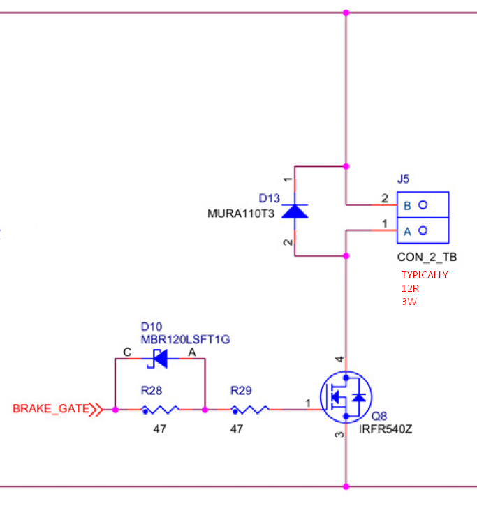

There are at least two ways how to measure DC link voltage.
If you measure Internal_3 GDU DC link voltage monitor ADC channel, the VHD is divided by the internal divider by 5. So, the first voltage calculation is correct Vhd = (34518 / 65536) * 5V range * 5 as divider = 13.1V.
If you measure Internal_2 GDU phase multiplexer voltage ADC channel and you set GDUPHMUX = 0x00, the VHD is divided by the internal divider by 12.
The HD high voltage monitor assert trippoint low is around 21V and HD high voltage monitor assert trippoint high is around 28V. The trippoint is selectable by GDUCTR_GHHDLVL bit.
In general, the High HD voltage might be caused by fast decreasing of motor speed. In that case, we may use brake chopper circuit which will be enabled by MCU software when VHD across some dedicated level. An example of brake chopper circuit:
It is hard to say what is wrong with your board. Is that flag present also when you load the empty project into MCU? Power down/up helps or not?
Writing 1 to GDUF_GHHDF should clear that flag when VHD voltage is below VHVHDLD (typ. 20.5V) or VHVHDHD (typ. 27.9V) voltage level.
However, it is possible that the GDU is somehow damaged.
