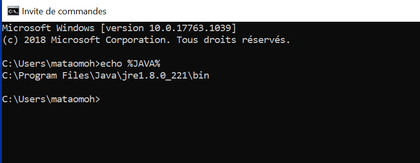

mataomoh1
Hello Hung,
I don't think that the leading cause is the PATH Environment of JAVA
as you can see below in the screenshot of my CMD the JAVA environment path already set:
so perhaps another cause , do you have any other idea ?
BR,
