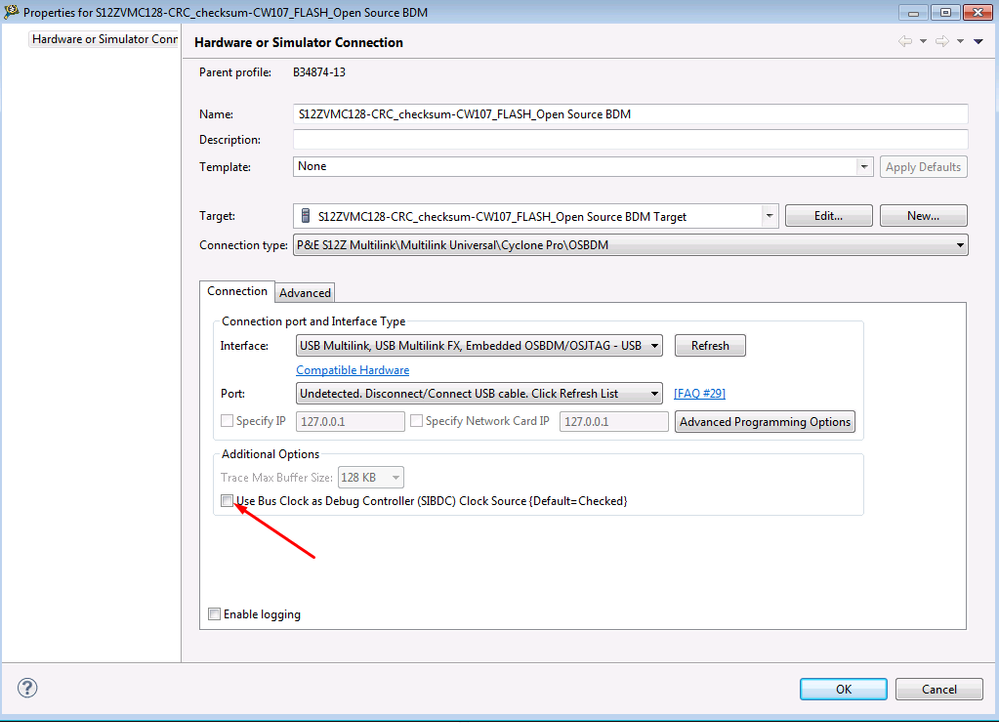

RadekS
Hello Chury,
I suppose that this will be not problem in MCU and code, but rather in debugger.
You probably use OSBDM interface on board. Correct?
When we change bus clock close to the maximum value, the BDM connection may be sometimes lost.
I would like to recommend change BDM clock to 1MHz (from IRC1M clock source).
In debug configuration, go to Target settings-Edit and Uncheck “Use Bus Clock as Debug Controller(SIBDC) Clock Source {default=Checked}”.
This should help. However, the loading/debugging will be a bit slower.
I hope it helps you.

churyjeong
Thanks Radek.
It's a very good comment. So far I didn't understand the operation of debugger fully, I'll ask further in other thread after learning deep further.

RadekS
Hello Chury,
Radek

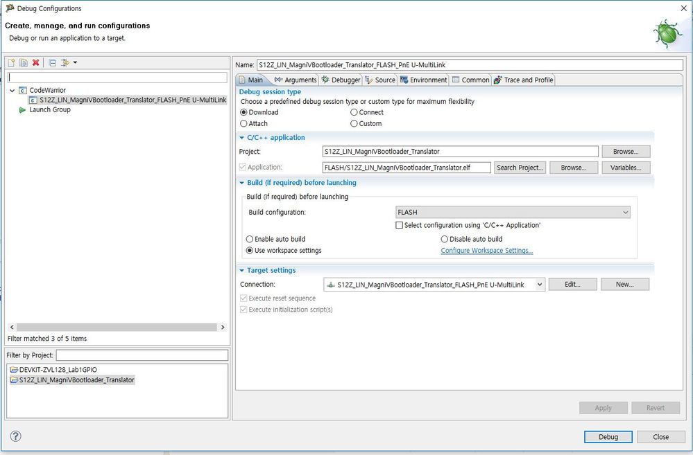

churyjeong
Thanks Radek.
I just realized S12Z_LIN_MagniVBootloader_Translator SW has not "OS BDM" debugger.
(I am not familiar with CodeWarrior too.)
It has only "PnE U-MultiLink" like the picture below:
In your picture, there are 3 debugger settings, but in my picture, it has only one debugger setting.
Could you let me know how to add "OS BDM" debugger into this project ?
Or if there's a helpful documents of adding  new debugger, please help me to find the document.
Chury

RadekS
Hi Chury,
No problem with debugger options. My screenshots were captured from a different project.
In fact, the PnE U-MultiLink and OSBDM  interfaces use the same PC software driver from P&E. So, you may use this configuration for both Multilink Universal or OSBDM interface types.
Anyway, new debugger configuration may be created by right-clicking on CodeWarrior and selection “New” in the context menu.
There is also “New…” button for creating new target settings.
