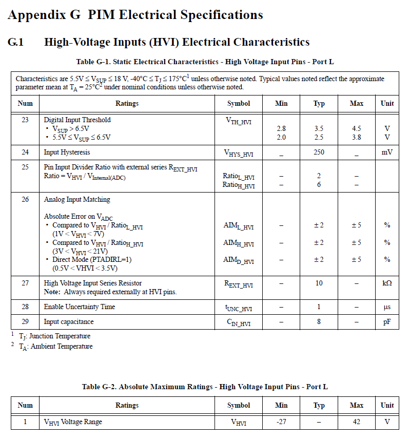

I use HVI0 to measure 0~30VDC. But I can not measure 22.2~30V.
The ADC result:
8bit ADC
5V ==> 43
10V ==> 86
15V ==> 129
20V ==> 172
22.1V ==> 190
25V ==> 190 (I got wrong value, It should be around 215)
30V ==> 190 (I got wrong value, It should be around 255)
10bit ADC
5V ==> 172
10V ==> 343
15V ==> 515
20V ==> 687
22.2V ==> 762
25V ==> 762 (I got wrong value, It should be around 859)
30V ==> 762 (I got wrong value, It should be around 1023)
What problem in my code?

Dear Daniel,
The HVI circuit has a standoff voltage. So, the HVI cannot reach the full scale of the ADC.
This answer is important for me. I get a deeper understanding of the HVI. Thank you.
I will use ratio H_HVI=6 to measure my signal (0~10V). And use 12-bit to increase resolution.
Now, I understand the Num.26 of Table G-1
Aaron

Hi Aaron,
I was wrong in my previous answer. Sorry for that. Your measurement is correct.
