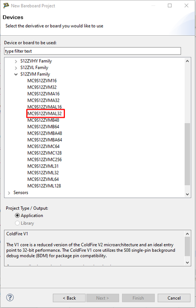

In order to start dev of a new ECU Project, I am using Codewarrior, but unfortunately the MCU choosed is not supported   "MC9S12ZVMAL3VLF"
Is there anyway to add it to my IDE and also have a SDK + LIN Slave Stack already existing that needs only configuration to fit my project needs?

The MC9S12ZVMAL3V part number isn't in the system and does not fit with standard nomenclature.
I expect some typo error in the part number.
Are you looking for :
Did you try to update your installation of the Codewarrior?
Unfortunately, we do not offer any SDK for S12Z devices.
The LIN stack is available at https://www.nxp.com/webapp/swlicensing/sso/downloadSoftware.sp?catid=SW-LIN2X-J2602-D
For a fresh start, you may use the Processor Expert tool for code generation and easy prototyping.
Or, you may look at some technical example code S12(X) and S12 MagniV - available Examples and Documents

You are right it was about ZVMAL32.
And thanks for LIN stack link, Is this Stack qualified for a use in serial production projects or it is just for Prototyping ?
