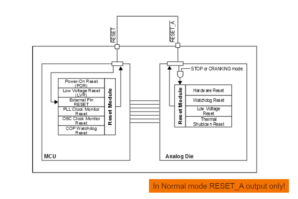

Q_man
In normal mode the uC can NOT reset the analog die using the RESET line. This also means a COP (uC) reset will NOT reset the analog die in Normal mode!
Therefore I recommend to use the watch-dog of the analog die to be able to bring the system (uC and analog die) back to a defined state if the watchdog has to kick.

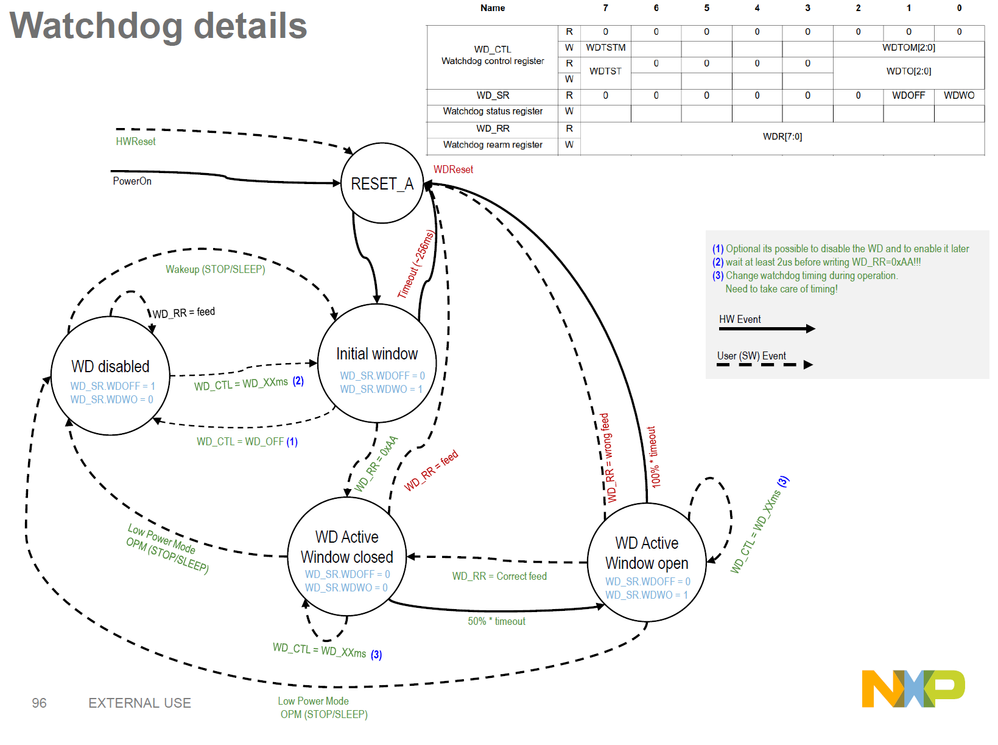

Q_man
Hi Mu,
there is no reference code as such.
Attached some driver code...
The state diagram show the usage / options of the watchdog:
E.g. its possible to enable the wd later after reset. You can change the timeout during operation. You can NOT disable the wd once it's enabled, etc...

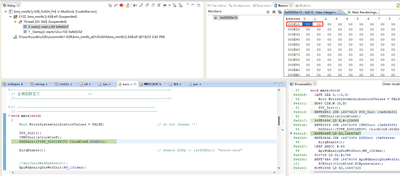

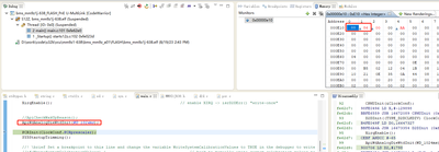

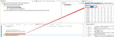

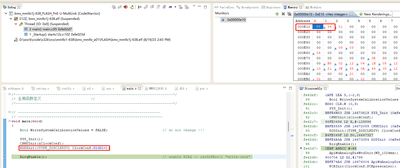

Thank you for your support! During the debugging of the window watchdog, I encountered a strange issue while trying to configure the watchdog timeout. Here are some screenshots of my step-by-step debugging.
1. system startup and WD_CTL register value is 0
2. after executing D2DInit(), WD_CTL register value is 0x0084
3. initial watch dog with timeout value 1024ms, the content of WD_CTL register is changed to 0x0086,it is the expected result.
4. after calling PCRInit(),the content of WD_CTL register is changed to 0x0084. timeout setting is default value (256ms)
I have checked the operations in the D2DInit() and PCRInit() functions, and there is no write operation to the WD_CTL register. I'm not sure why executing these two functions would affect the WD_CTL. If that's the case, how can I modify the watchdog timeout value?

Q_man
Hi Mu,
your experiment makes sense! Here my comments to your steps 1 to 4
1. before the D2DInit() -> you can not access registers on the analog die
2. after the D2DInit() you can access the registers and get the correct reading (default value) 0x84
3. you write was done
4. the watchdog is always running, even if you have stopped the uC during debugging! That's why the value is changing back to the default 0x84 value after the watchdog has reset the analog die
You can not use the debugger to "debug the watchdog". As said its always running independent of the uC stepping mode. Any debugging has to be done in real time with the code be executed!

Q_man
Hi Mu,
please also see above!
The watchdog operation is independent of the 470nF. The 470nF externally "filters" reset pulses generated by the analog die (RESET_A output) to cause resetting the uC (RESET input).
RESET_A  ---- [blocked by 470nF]  ---> RESET
