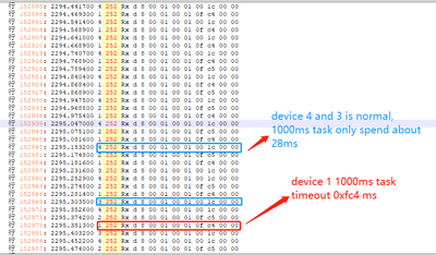

Recently, I have beeing doing sleep/wakeup stress tests for our project.There is an issue about watchdog timeout issue that will reset the device.
Here is my experimental environment:
1.monitoring eclipsed time for every task,(5ms task, 100ms task, 1000ms task)
2.make system enter stop mode  every 5s in 1000ms task, wakeup device in 5s with rtc
3. use a CAN frame to send the max eclipsed time of task
4. 4 DUT
testing data:

COP and API should be disabled in stop mode. Under normal conditions, COP and API were indeed disabled for device 4 and 3, abnormal conditions, COP and API still run.  COP will reset device because I have enabled COP.
I'd like to know what factors are influencing to stop the COP.

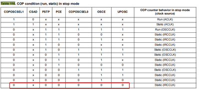

Hi Mu,
I still do not understand your setup.
Which clock source is used by the COP? Which configuration do you use?

gumu
Contributor V
Hi @Q_man ,
I checked the relative registers. The current configuration is Static (IRCCLK),

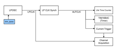

1,988 Views
Q_man
Hi Mu,
I"m not sure if I fully understand your setup, but it seems you are using the device in a not common way.
To optimize low power consumption the analog die is fully controlling the wakeup from system stop and sleep modes. There is no mechanism that the uC can wakeup the analog die / system! Doing so, might lead to strange effects, typically triggering a low voltage reset, as the current capability of the Vreg (VDDX = 5V) is limited to ~3mA in stop (analog die) mode.
To self wakeup the device after time a timer (TIM16B4C) has to be used, which is located and clocked on the analog die.
W.

gumu
Contributor V
Hi @Q_man ,
Agreed with what you said. In my experiment, the microcontroller is responsible for calling the device's sleep function every 5 seconds, and then it is awakened by the LFT after 5 seconds, and this process repeats in a loop. When this probabilistic issue occurs, the RTI clock and COP are still operational. Otherwise, there should not be a delay of several seconds from sleep to awakening. As shown in my screenshot, the 1000ms task took a long time to complete.

gumu
Contributor V
Dear Sir,
Please let me add, this issue is very low probability, it only happens once every few hours.
There is a section in the datasheet 6.2.1.8.4:
The clock source for the COP is either ACLK, IRCCLK or OSCCLK depending on the setting of the COPOSCSEL0 and COPOSCSEL1 bit.
Due to clock domain crossing synchronization there is a latency time to enter and exit Stop mode if the COP clock source is ACLK and
this clock is stopped in Stop mode. This maximum total latency time is 4 ACLK cycles (2 ACLK cycles for Stop mode entry and exit each)
which must be added to the Stop mode recovery time tSTP_REC from exit of current Stop mode to entry of next Stop mode. This latency
time occurs no matter which Stop mode (Full, Pseudo) is currently exited or entered next.
After exit from Stop mode (Pseudo, Full) for this latency time of 2 ACLK cycles no Stop mode request (STOP instruction) should be
generated to make sure the COP counter can increment at each Stop mode exit.
 Do I need add some delay function?
