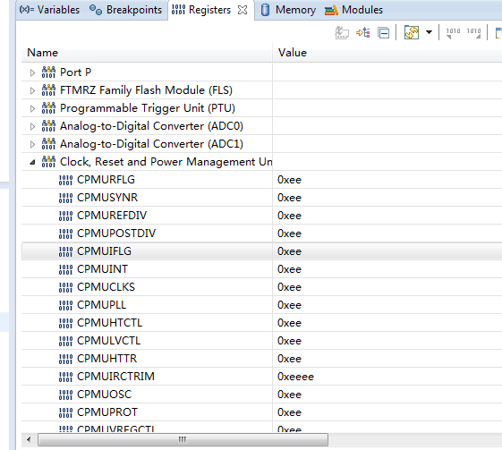

    I,m using the bootloader on S12ZVML31. The example is AN4723. I can't configure the CPMU now.  All the redisters will become 0xee after CPMUOSC_OSCE = 1;(CPMUOSC_OSCE = 0).
What is wrong in my code? S12ZVM_Bootloader is my own code, AN4723 is the example from nxp.com

The BDM module returns 0xEE for each data byte as a response to an illegal access.
Do you lose connection with the board?

frankkong
   The connection is not lose. I had test the other project , it works well. Can you test the new code? My board isS12ZVMx12EVB, using the OSBDM on the board.

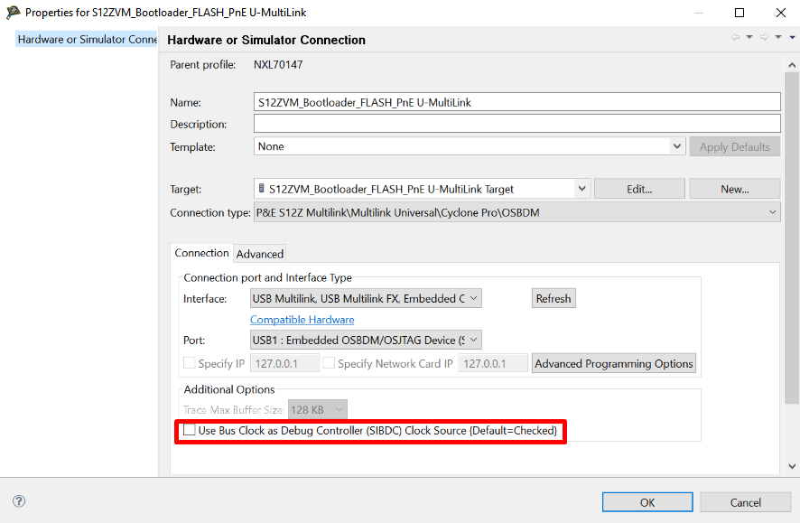

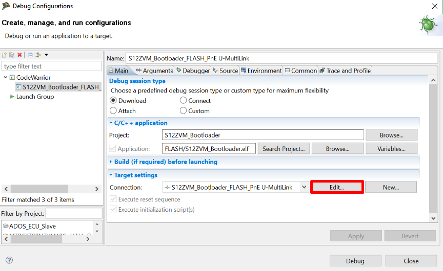

danielmartynek
Please disable the Use Bus Clock as Debug Controller clock option.

frankkong
  It works.
