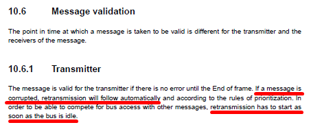

danielmartynek
This is required by the CAN standard.
You can refer to: https://www.nxp.com/files/microcontrollers/doc/data_sheet/BCANPSV2.pdf

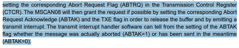

peteyo
Hi Daniel,
I found a setting as below and it seems like this setting could stop retransmission even there is an error or non-ACK situation. If I schedule a 250ms cycle time transmission with setting these bits high and  then remove other devices on the bus(only one device on the bus), the CAN bus signals would keep in 250ms.(sometimes loss but no retransmission)
