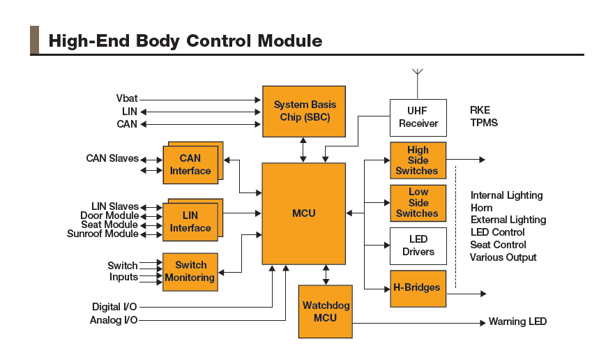

I'd like to choice the device for BCM.
I want to add an application in BCM. _ Gateway, RKE, TPMS
so I find a document of below.
Q1. What kind of to use a product of mcu?
       Would you please kindly provide a product of mcu?
Q2. I need to use an UHF receiver.
       Would you please recommend to me a product on this?
Thanks.

Dear Radek,
I will use 4-ch of CAN interface.so I don't use the magniV.
Do you know how i can use gateway and RKE and TPMS in BCM?
I'd like to use all of them in one chip.

Personally I don’t have any such radio stuff, but basically, you interface it simply trough SPI or I2C
http://www.nxp.com/products/identification-and-security/secure-car-access/remote-keyless-entry:MC_71...
http://www.nxp.com/products/interface-and-connectivity/interface-and-system-management/advanced-auto...
As you mentioned 4 CAN channels, only S12XE family or MPC MCUs are possible to use (without simplest MPC5602B, MPC5603B, MPC5604B, MPC560xD derivatives).
Note: We are working also on next generation of GP automotive MCU with ARM core, but it is still not available and the first derivatives will have less than 4 CANs.
http://www.nxp.com/products/microcontrollers-and-processors/arm-processors/s32-arm-processors-microc...

Please look at automotive selector guide:
http://www.nxp.com/files/microcontrollers/doc/selector_guide/SG187.pdf
The recommended MCUs for Body Control Module and Gateway are MPC5668x, MPC560xB, MPC560xD, MPC564xB/C, MPC5746G, MPC5747C, MPC5747G, MPC5748C, MPC5748G, S12G, S12XE, KEA
The MPC5668x is rather Gateway.
The others MPC5 controllers are high-end Body Control MCUs.
The S12G(S12 core) and Kinetis KEA (ARM M0+ core) are rather Low-End Body Control MCUs.
The S12XE performance is something between S12G and MPC5 MCUs.
It depends how big computing power you need, how much CAN/LIN channels you need, what other interfaces you need, ….
About UHF receiver)
We could offer for example MC33596: PLL Tuned UHF Receiver:
http://www.nxp.com/products/interface-and-connectivity/wireless-connectivity/sub-1-ghz-wireless-solu...
or NCK2983AHN: Low Power Multi-Channel UHF Transceiver - Triple Receiver
http://www.nxp.com/products/identification-and-security/secure-car-access/rf-link/low-power-multi-ch...
I hope it helps you.
Radek
