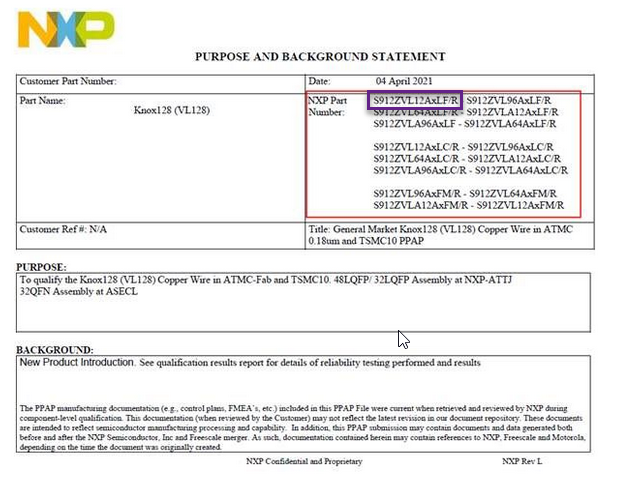

There is another question. Why does the part number appear to be missing in the PPAP file?

danielmartynek
Hi @Yudong,
If you mean S912ZVL12F0MLF, it is there:
