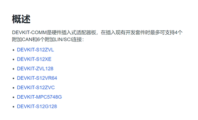

I want to realize canfd communication between computers. When I look at devkit series products, I find that they all have can modules, but what I describe is that they support can communication. However, I find the schematic diagram of these products and find that the can chip used supports canfd communication. Do these products support canfd communication? I want to realize the communication between computers through canfd. Do you have any suggested products?

Hello @tianzhejia,
Only the MPC5748G out of these supports CANFD,
You can use S32K1xx.
https://www.nxp.com/products/processors-and-microcontrollers/arm-microcontrollers/s32k-automotive-mc...
