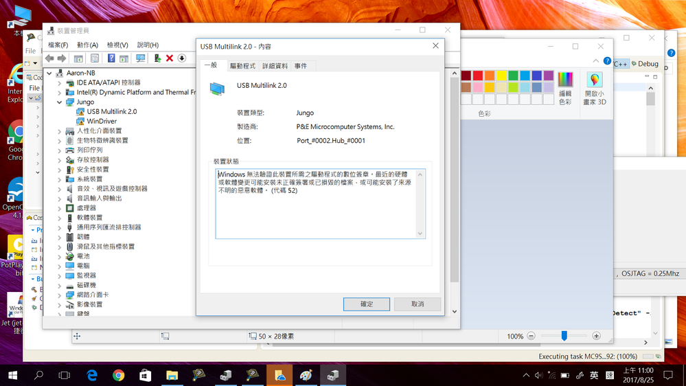

I buy the new notebook. O.S. is windows 10.
I install the following software
  • CodeWarrior for MCU Version: 10.7 Build Id:160721
  • multilink_universal_install
The Multilink Universal can not work with my new notebook.
The Device manager as following:
I try many way, but the issue still here. Any recommend?
Aaron
2,997件の閲覧回数
aaronlee
Contributor V
I resolved the problem.
FAQ Link: PEmicro FAQ
Driver download:  P&E Hardware Interface Drivers, Version 12 (Win XP/Vista/7/8/10)
Aaron
