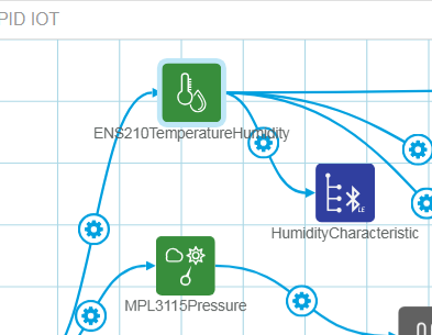

For example if you open the Weather Station demo project and check the Temperature/Humidity characteristics:
you will note that the temperature sensor has a preset I2C address corresponding to the hardware wiring inside the kit as on following screenshot:
This means that Rapid IoT studio is acutally managing and generating the code for you so that you do not have to bother about managing the I²C bus messages.

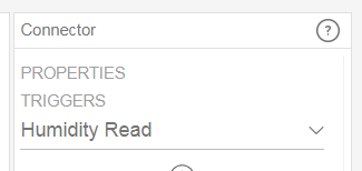

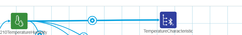

If you check the characteristics of the trigger connecting the sensor to the BLE characteristics you will see it is a read operation:
What this connectors does is to trigger an I²C read of the sensor, extract the humidity information from the full I²C message and post it to the corresponding BLE characteristics.
