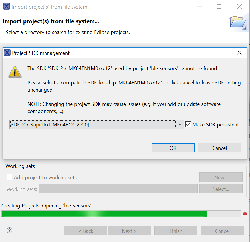

My experience so far (commit a1abcc96b1fca33caee172b31eb09d93e288c0bd):
SDK not found warning
When I import the project, a dialog appears:
After confirming the active selection (there are no other selections), the import completes. Question: is this warning harmful?

Thanks for this feedback. Fix has been push to the repo.
You can ignore this warning, this is not harmfull.
