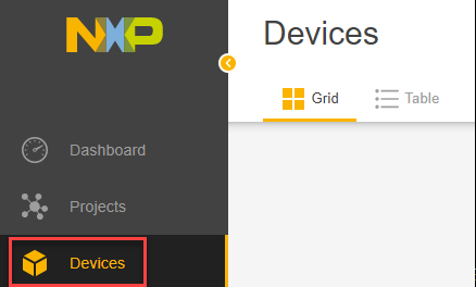

Hi Prachi, I hope you're doing well!
Could you please try clearing previously connected devices from your account on the Rapid IOT Studio online IDE?
It can be done in the "Devices" menu on the left of the page layout:
Please let me know if you continue to have issues.
